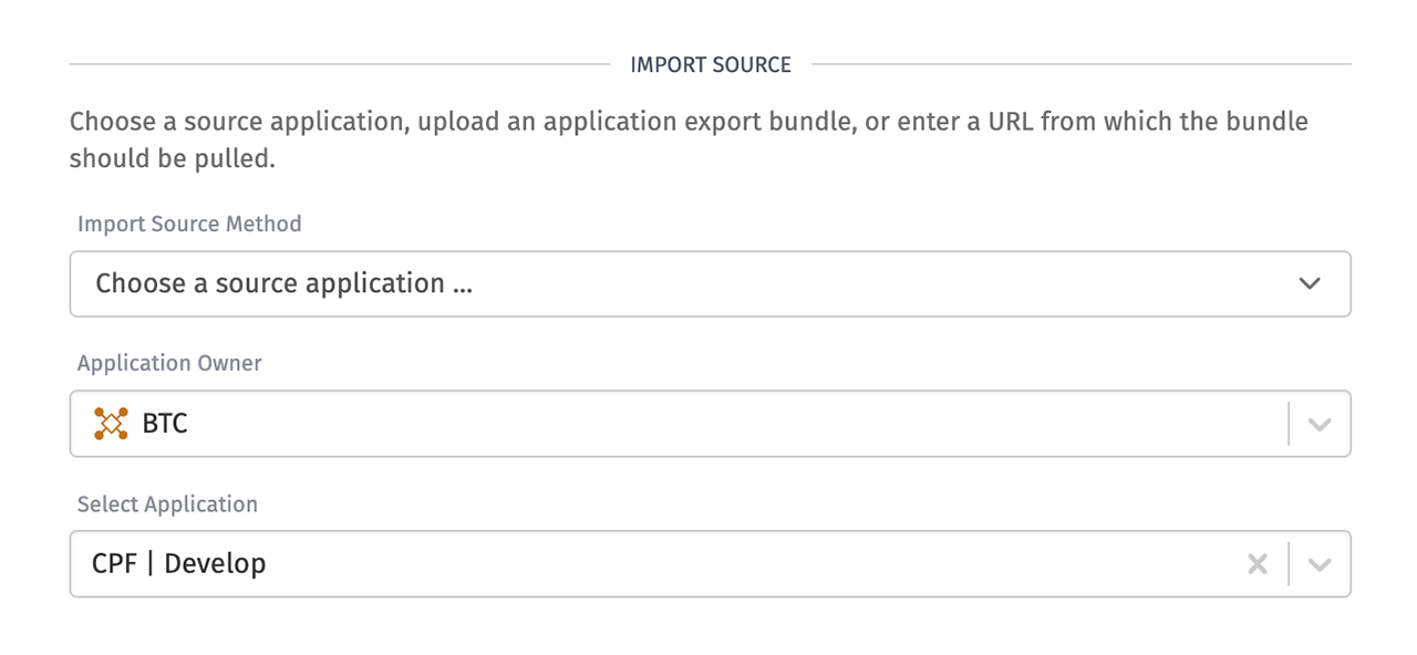

Application import and export is the foundation for lifecycle management within Losant. To promote changes, you'd export your develop application and import it into your staging or production application. With today's update, that export step is no longer required. You can now directly choose an application that you'd like to import.
The screenshot above shows the updated user interface where "Choose a source application..." has been added as an available import source. When you select this option, the platform will automatically handle the export process for you and then import the result.
This option streamlines the import process and reduces potential errors caused by accidentally importing the wrong export file.

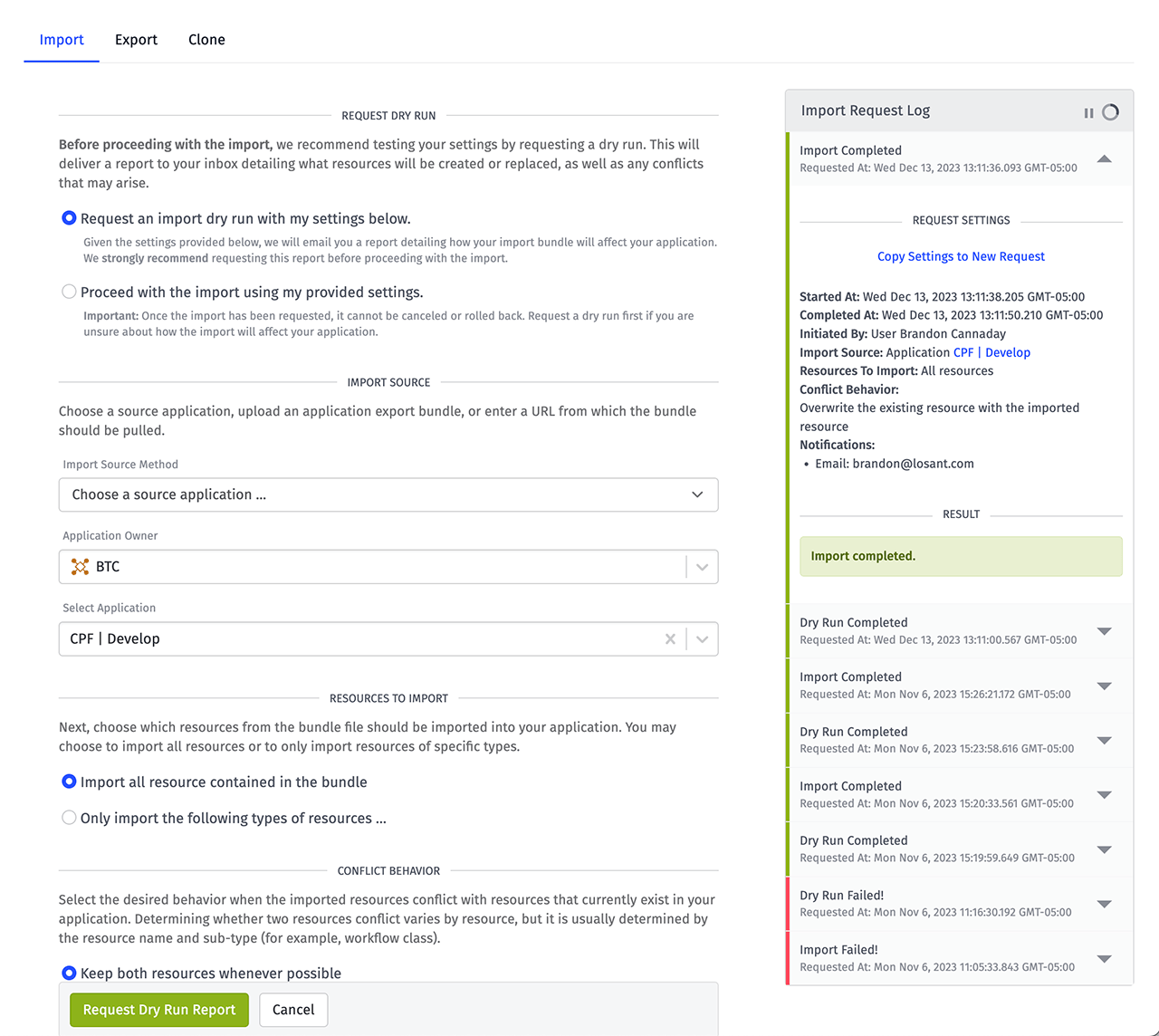

Application Import Log
To further improve the application import experience, we've added a log that displays the details and results of past imports.
One of the most useful aspects of this log is the "Copy Settings to New Request" button. This makes it easy to quickly perform imports using the same settings as a previous import. This is particularly helpful when you're importing a subset of resources since this saves the time of having to recheck every required resource.
