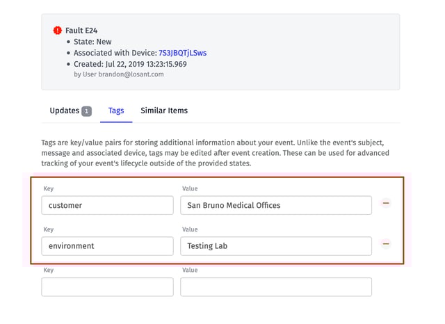

Event Tags
Along with an associated Device, there was a need to tag Events with other arbitrary key/value data based on your specific application requirements. This release adds Event Tags, which allow you to add metadata to your Events. You can also query Events based on these tags on Dashboards and in Workflows.

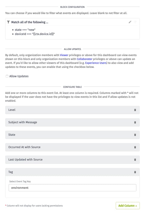

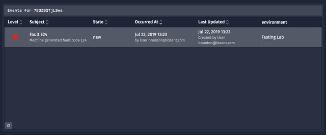

Improved Event List Dashboard Block Query and Display Options
To help make use of the new Device association and Event Tags, we've also released a major revamp to the existing Event List Dashboard Block. You now have much more power over how you query Events for this list, including querying by Device and tags. You can now also customize which columns show up in the resulting table. This is useful for adding columns for your custom tags or removing built-in columns that you may not need.

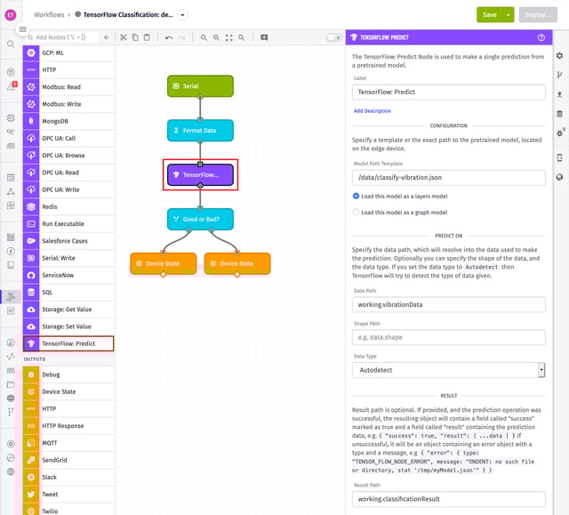

TensorFlow for Edge Compute
Moving compute at or near the device greatly increases the types of complex analytics that can be performed. There are times when the amount of data being analyzed requires too much bandwidth to send to the cloud. The round-trip to the cloud and back can also take too much time for certain applications that require real-time results. To address these scenarios, today's release adds the TensorFlow: Predict Node for Edge Workflows.
With the TensorFlow: Predict Node, you can now build Edge Workflows that stream data directly into a TensorFlow.js model in real time.
The above example demonstrates how to do complex vibration analysis using this functionality. We have a piece of equipment in our lab that allows us to alter the vibration characteristics through axle misalignment. We collected thousands of samples while the machine was running well and when the machine was running with a misaligned axle. We then trained a machine learning model using TensorFlow and put that model on a gateway near the equipment. Using this model and the above Workflow, we can classify the vibration data in real time to detect any future axle misalignment.
