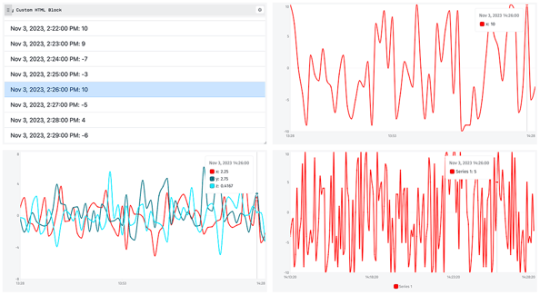

Synced Graph Tooltips
First, users have always been able to hover their mouse over a graph point to display a tooltip with the values of all segments at that timestamp. Starting with today’s release, hovering over a graph will also display tooltips in all other Time Series Graphs that have data at the same timestamp. This allows for building richer data comparisons across different devices and attributes without overloading a single block with too many segments.
synced-time-series-graphs
On top of that, we’ve added the ability to sync tooltip activity to Custom HTML Blocks. Users can opt into receiving tooltipChange events dispatched from Time Series Graphs, and can also control the tooltip behavior by invoking a new setTooltipState() method from their custom block code. In other words, user behavior can be tracked, synced, and managed across different blocks and different graphing libraries.
We’ve included a basic example that demonstrates bi-directional syncing of tooltip behavior between a Custom HTML Block and Time Series Graphs in our documentation. Developers can start from this and expand upon it to build more advanced dashboards that will better serve their end users.

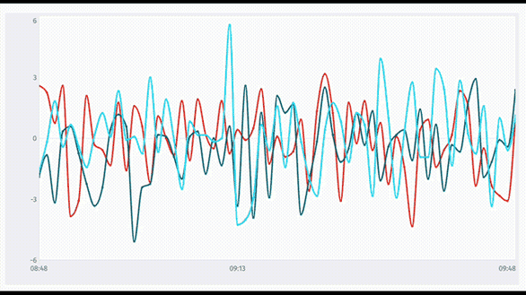

Next, we’ve had several requests for zoomable graphs—as in, allowing users to press, move, and release the cursor to narrow the range of a graph for a closer look at its data. Today’s release delivers on that request.
Clicking on a data point and then dragging will display a zoom box that indicates the block’s new time range as you move your mouse. Releasing will fetch and display new data for that selected time range. Losant will automatically pick a resolution matching the data granularity of the block’s original configuration, though this resolution can be changed in the block’s time selector dropdown.
time-series-graph-zoom-crunched
The feature is only available if developers have opted in to allow users to change a block’s duration and resolution—which is the default for all new Time Series Graphs. On that note, we have also de-cluttered the block’s display by removing the time selector button from the top right corner - except when hovering your mouse over the block or when a custom time range is applied.

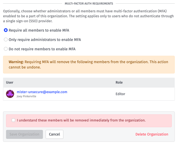

Organization Membership MFA Requirements
Today’s release also improves the security of organizations by allowing administrators to add multi-factor authentication (MFA) requirements for members.
Administrators may require all members of the organization to have MFA enabled on their Losant accounts - or, alternatively, to only require that extra security layer for administrators. Prior to enabling either feature, administrators will see a list of users who will be affected by the change - whether they will be removed from the organization or have their privileges downgraded. (Users who authenticate through a Single-Sign On provider are considered in compliance with the MFA requirement automatically.)
org-mfa-requirements
Multi-factor authentication is a simple addition to any account that greatly improves online security. Losant recommends that all users enable this extra protection for the sake of their IoT applications, and now organizations can enforce this requirement to meet their own internal company policies.
