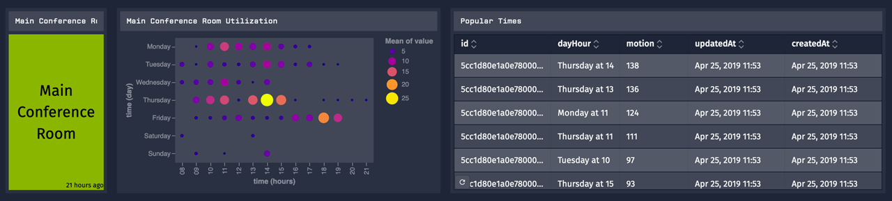

First, here's the end result of what I'm building. It shows the visual aggregation of the most popular days and times on the left with a sorted table on the right. The table on the right is created using Losant Notebooks.

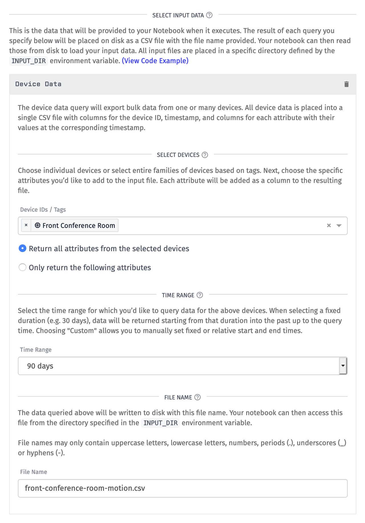

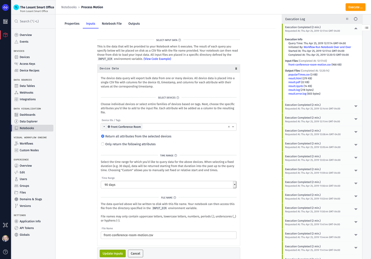

Step 1: Configure Inputs
The first step in creating a Losant Notebook is to configure the input data that will be made available to the notebook when it executes.
There are several types of data you can input, but for this walkthrough I need the motion sensor data from my "Front Conference Room" device. I then select the most recent 90 days of data and specify the file name to be "front-conference-room-motion.csv". Inputs control which data will be queried and made available to your notebook when it executes in our managed environment. It does this by downloading the data and writing it to disk next to your notebook at the file name you provided. When your notebook executes, it can read that data from the directory specified by the INPUT_DIR environment variable.

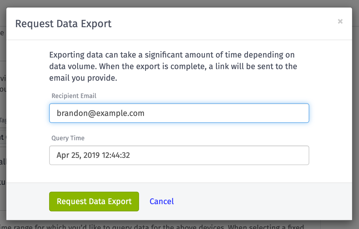

Step 2: Request a Data Export

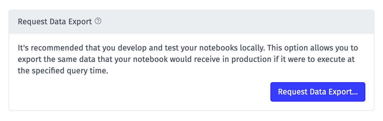

Losant does not provide an authoring environment for writing the Jupyter Notebook itself. This means you'll need to request a data export so you'll have some example data to work with. The data you receive will be in the exact same format that your notebook will see when executing in our environment.
Once you've configured all required inputs, click the Request Data Export button at the bottom of the Inputs tab.
This will display a popup with additional options.
Since a data export can take a while, we will email the specified recipient with download links to their exported data. The Query Time lets you change the anchor point against which your device data is queried. In the example above, I'm querying 90 days of device data. By default, the query time is equal to the current time, so I'm querying the most recent 90 days of data. However, I could change the query time to allow me to query 90 days relative to some point in the past.

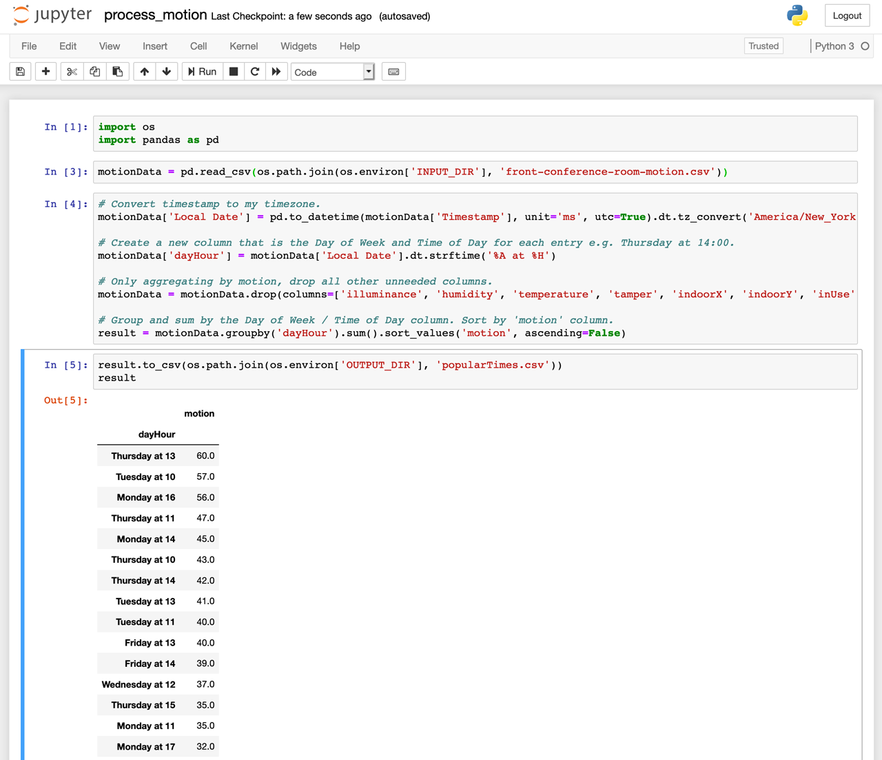

Now that you have some data to work with, you can use any Jupyter environment you like to build and test your notebook. For this example, I ran Jupyter on my local computer. There are several cloud-based Jupyter environments you could use as well. Our Notebook Writing Guide contains lots of useful information on how to write a notebook that will be compatible with our platform.
Our execution environment runs Jupyter Notebook v5.7.8 with Python 3.7.3. When developing locally, it's recommended to run the same versions to ensure compatibility. You can see these and all other available libraries on our execution environment documentation.
When notebooks are executed in our environment, they must be configured to read data from the directory specified by the INPUT_DIR environment variable. When running locally, you can provide those same environment variables by using the following command when running Jupyter Notebook.
INPUT_DIR=$(pwd) OUTPUT_DIR=$(pwd) jupyter-notebook
The above command will set INPUT_DIR and OUTPUT_DIR to your current directory. If you place your exported data files into that directory, the notebook you create should work the same both locally and in our environment when it comes to reading and writing files. If you don't have access to environment variables, you'll just have to make sure to adjust your code prior to uploading the notebook to our platform.
My entire notebook is above. I won't cover the details because everyone's notebook will be different and extremely specific to the insights you're trying to derive. However, it is important to point out the cells that are reading and writing data:
motionData = pd.read_csv(os.path.join(os.environ['INPUT_DIR'], 'front-conference-room-motion.csv'))
result.to_csv(os.path.join(os.environ['OUTPUT_DIR'], 'popularTimes.csv')
This is how data gets in and out of your notebook when executed in our environment. Every input you specify will be downloaded and available in the directory specified by the INPUT_DIR environment variable. If your notebook creates any results that you'd like to make available back to Losant, you'll need to save to those as files in the directory specified by the OUTPUT_DIR environment variable. In my example, I'm outputting a CSV file that contains the most active times in this conference room.

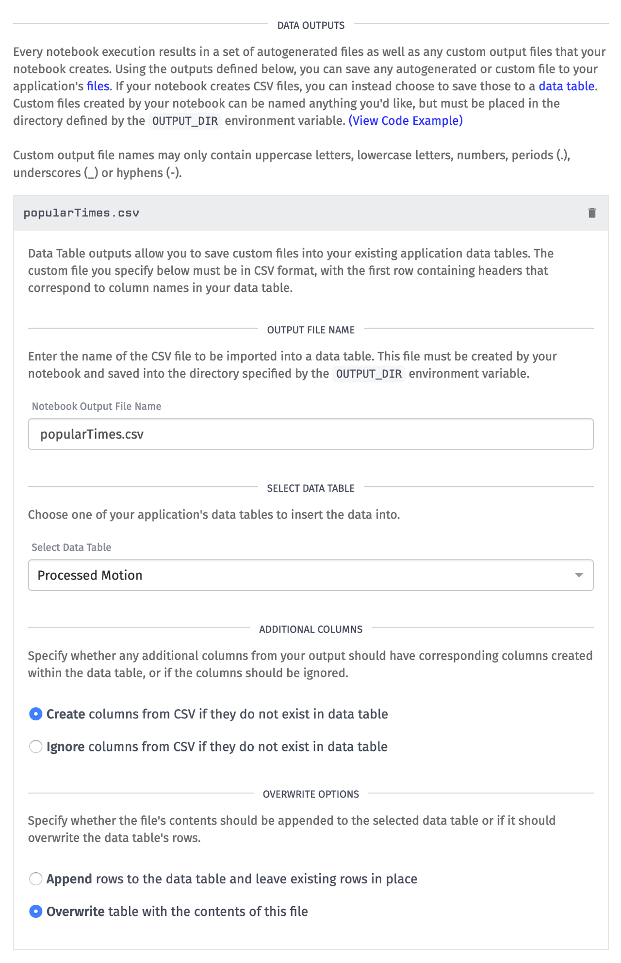

Now that my notebook is generating output files and saving them into the directory specified by the OUTPUT_DIR environment variable, I can instruct Losant to do something with that data. I can either save it into Files or a Data Table. In this example, I want the results to be saved into a Data Table.
The Notebook Output File Name should be identical to the file name that your notebook created. In my example, it was "popularTimes.csv". I chose to have Losant automatically add columns that are present in the CSV but not in my selected table. This will allow any additional columns generated by my notebook to be automatically added in future executions. I also chose to overwrite existing data. I want this table to always be the most up-to-date information on the most popular times for this conference room.

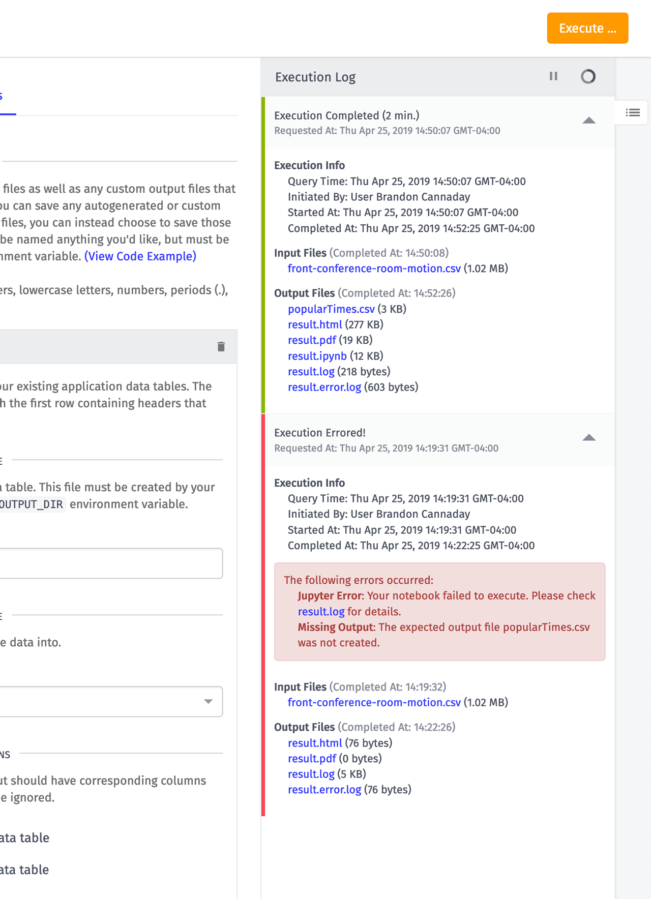

Now that you have inputs, a Jupyter Notebook file, and outputs, you can execute this Losant Notebook. Executing a notebook can be done in two ways. You can manually execute the notebook using the Execute button on the top-right of the screen, or you can execute one in a workflow using the Notebook: Execute Node. You should always first execute it manually to ensure there are no errors.
Every execution of a notebook is done in a single-use and dedicated VM to ensure the highest level of security and isolation. Spinning up this VM and performing the data export for your input data can take a couple of minutes. When the execution is complete, the execution log is a helpful place to check the results and debug any errors.
We automatically store the executed notebook in many different formats (html, pdf, and ipynb) and make those available for easy download in the execution log. If your notebook did fail to execute, the result.log file will contain a useful stack trace.

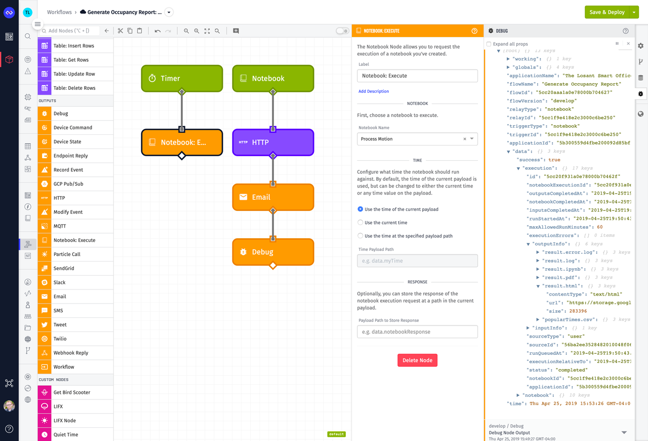

Now that I've confirmed my notebook executes and it creates the outputs I expect, the last thing I want to do is run this every Monday morning at 9:00 a.m. and email myself a report. Thanks to the Notebook Trigger and Notebook: Execute Nodes, building this workflow is easy.
The Timer Trigger on the left executes the notebook every day at 9:00 a.m. The Notebook Trigger on the left will fire whenever that notebook execution completes. The HTTP Node downloads the contents of result.html, which is an autogenerated file we provide for you that contains the executed notebook. The Email Node then emails me that HTML. This is essentially a complete data pipeline and business process implemented in six workflow nodes.
