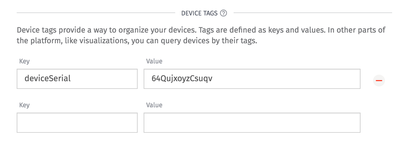

Our devices in DynamoDB are stored by device serial numbers, not by Losant device IDs – the first step is to make sure that the serial numbers are available on our Losant devices. We do this with device tags, either through our bulk creation process (which would let you import a CSV of all of the serial numbers and create the devices), or just by adding tags manually. By having the serial as a tag, we will have the serial number available for use as a lookup key later. Below you can see one such tag, where the device has the the deviceSerial tag of 64QujxoyzCsuqv.
