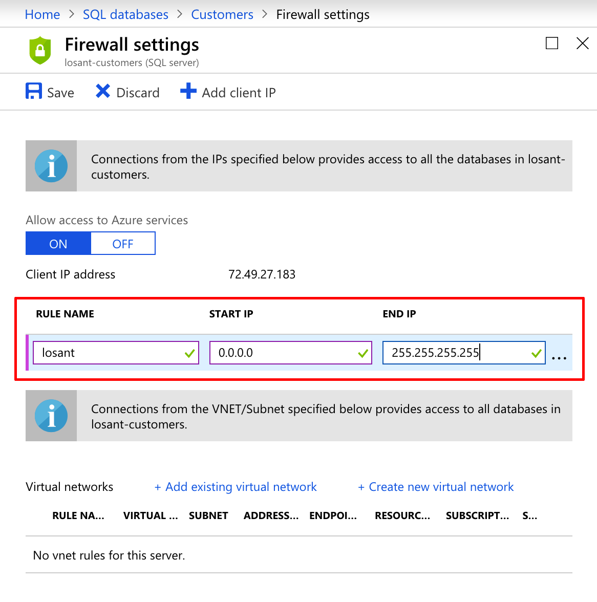

Azure requires you to whitelist any IP addresses that will connect to your database instance. Since Losant is a high-availability and fault-tolerant system, we utilize many outgoing IP addresses that can change at any time. Due to this, we are unable to publish a set of IP addresses for whitelisting when using Losant's fully-managed cloud environment. This means you're required to open all IP addresses (0.0.0.0 - 255.255.255.255) for database access. Although this does have security implications, all connections to Azure SQL databases are fully encrypted in transit, so your information is safe. Enterprise installs of Losant with dedicated infrastructure do have access to a known set of IP addresses. Please contact sales if this is something you'd be interested in.
To add a firewall rule, click the Set server firewall menu item on the database overview page.
Next, add a firewall rule for Losant with the IP range set to 0.0.0.0 to 255.255.255.255.
When complete, click the Save button at the top. At this point, you can now connect to this database from a Losant workflow.

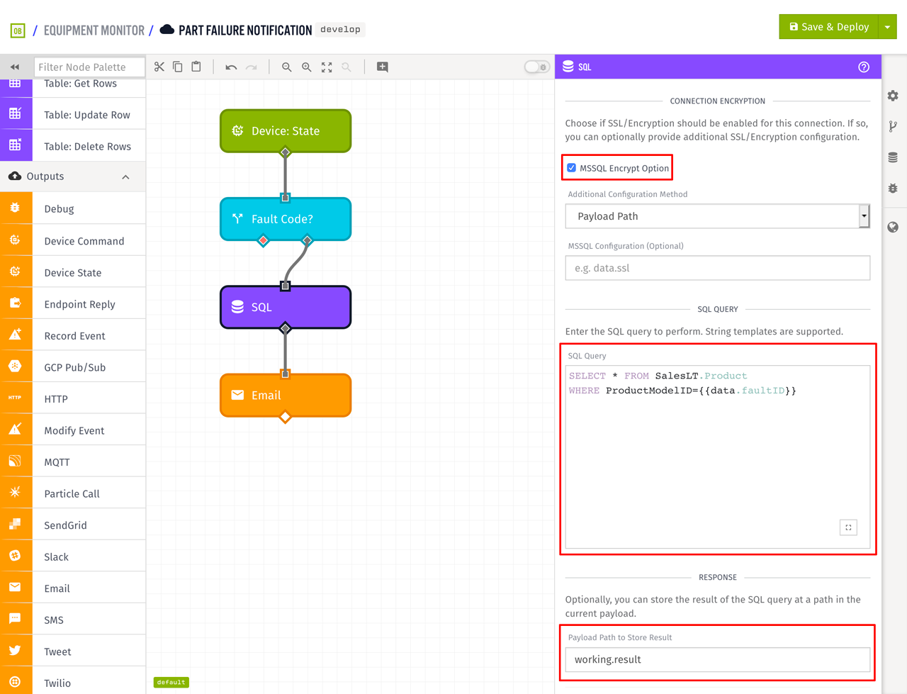

The screenshot above is showing a good example of when to integrate data from a SQL database. In this example, a company's part information is stored in SQL. Whenever a device reports a fault code, which may indicate a failed part, the workflow will query the SQL database for additional information. An email notification is then sent to the user with the fault details and the specific part metadata.

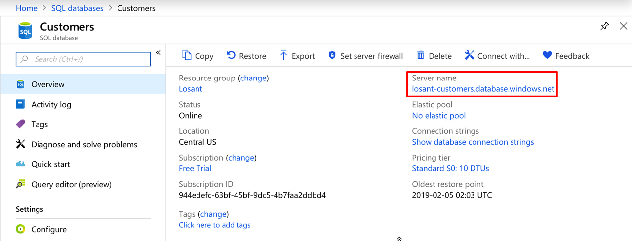

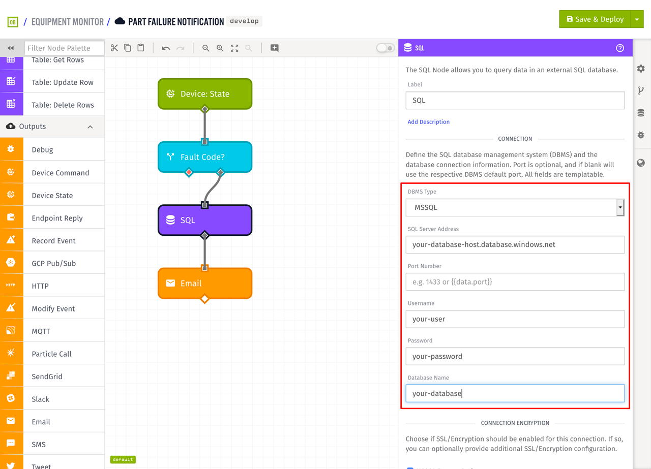

Losant's SQL Node configuration is split into three parts: connection details, encryption settings, and the query to execute. You can get the SQL Server Address from your database overview page on Azure.
The Username and Password come from the user you created in step 2. The Database Name is the actual database you'd like to query.
Azure requires encryption to be enabled, so check the MSSQL Encrypt Option checkbox. Azure does not require or support any additional SSL configuration, so those fields should be left blank.
Next, provide the actual query to execute on your database. The query in the example above is the following:
SELECT * FROM SalesLT.Product
WHERE ProductModelID={{data.faultID}}
As you can see from the example, the query field supports templates, so you can inject payload data into your query. In this case, the device is sending an ID for the fault that we can use to look up the matching part.

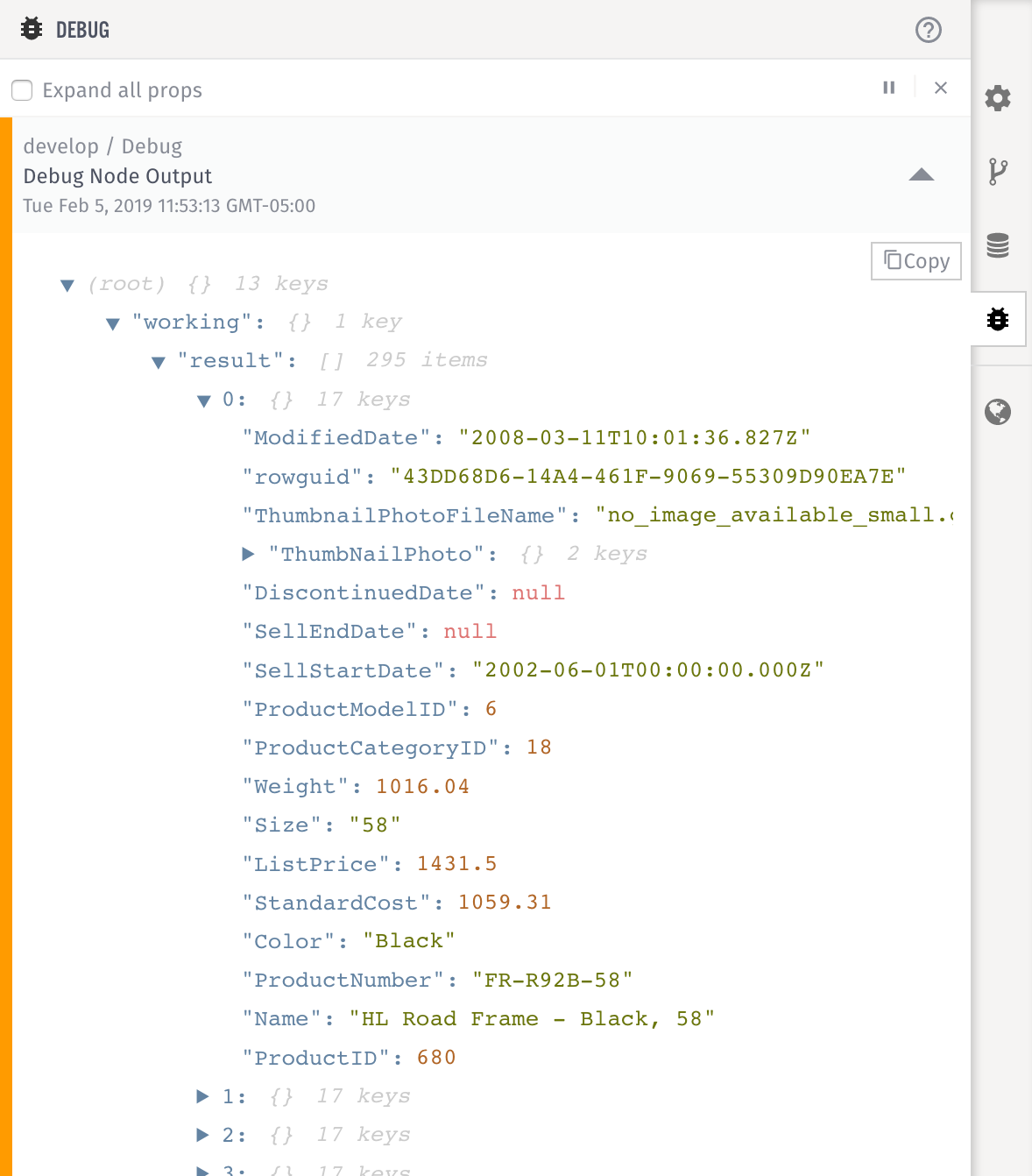

Once the query completes, an array of results will be placed on the payload based on what you specified in the Payload Path to Store Result field.
In the screenshot above, my array of results was placed on the payload at working.result. You can then use this data in any subsequent nodes. In this example, we are using this additional data in the notification sent to the user so they can more easily re-order a replacement part.
