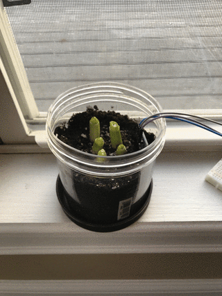

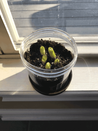

Then, put the soil in the container and push the green onion bulbs into the soil. In the beginning, the final product looked like this:
![green_onion_start.png](https://www.losant.com/hs-fs/hubfs/Blog/Growing_Green_Onions/green_onion_start.png?width=320&name=green_onion_start.png)
I know what you’re thinking: “How did he kill his green onions even though it is so easy?” Yes, I know. It’s pretty sad. That’s why blog post even exists. But, now that we have onions in the works let's monitor them.

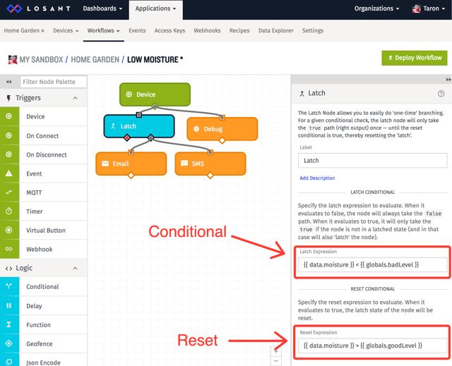

Workflow
Every time we get a moisture level, we need to check the moisture level. If it's below a certain level, I'll need a text to remind me to water my onions. In Losant we can build a workflow and use the Latch node for this purpose.
![green_onion_workflow.png](https://www.losant.com/hs-fs/hubfs/Blog/Growing_Green_Onions/green_onion_workflow.png?width=640&name=green_onion_workflow.png)
In this workflow, we capture the payload. If it's below the “badLevel,” let's shoot me an email and text. Determining what's "bad" depends on a bunch of factors. After looking at the data and seeing how dry the soil is, you'll get a good grasp on a good and bad level.
The Latch node will only take the successful condition once until reset. So, in this case, we only want one text, not one text every minute. Using the Latch node, we will only get a text once, unless the moisture level goes above our "goodLevel" to reset the latch.
We have nothing on for the negative case of the Latch node because we do not have to do anything when all is well.

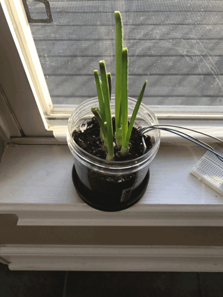

Let It Grow
After about two weeks, your onions should look like this:
![green_onion_growth.png](https://www.losant.com/hs-fs/hubfs/Blog/Growing_Green_Onions/green_onion_growth.png?width=320&name=green_onion_growth.png)
Also, because of the workflow, you should also get alerts when you need to water the plant.

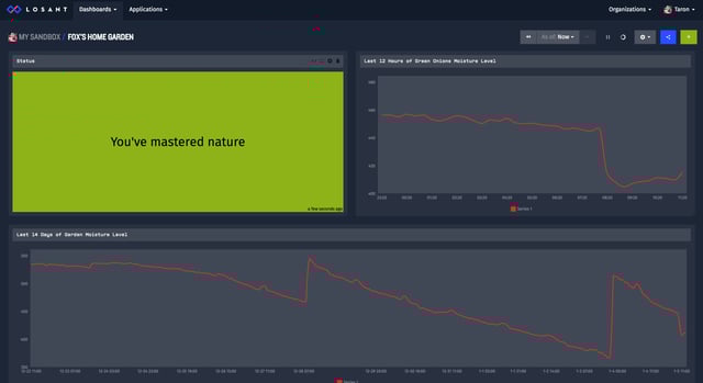

DASHBOARD
After data had started to populate in Losant, I thought it would be interesting to see a dashboard of a status and trends of my plant's moisture levels. It would also come in handy when I have more than one plant to manage. After I put together an indicator block and some time series graphs, Voilà:
![green_onion_dashboard.png](https://www.losant.com/hs-fs/hubfs/Blog/Growing_Green_Onions/green_onion_dashboard.png?width=640&name=green_onion_dashboard.png)
You can also see a live version of this dashboard.
