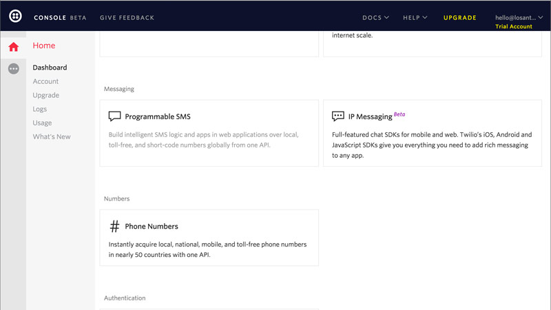

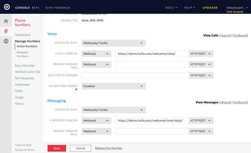

The first thing that needs to be done is signing up for Twilio and getting a phone number that will be used for the bot. Once signed up, you'll have to verify your account with a text code. In the dashboard you need to go to the home area and scroll down to phone numbers.
![twilio_home.jpg Twilio home navigation](https://www.losant.com/hs-fs/hubfs/Blog/_Twilio_Losant_SMS_Bot/twilio_home.jpg?width=460&name=twilio_home.jpg)
![twilio_phone_numbers_section.jpg twilio_phone_numbers_section.jpg](https://www.losant.com/hs-fs/hubfs/Blog/_Twilio_Losant_SMS_Bot/twilio_phone_numbers_section.jpg?width=666&name=twilio_phone_numbers_section.jpg)
In the Phone Number section you just need to click through "Get Started" and then "Get your first Twilio phone number". Twilio will then show you your phone number and you can "Choose this Number". Once completed you'll be dropped back at the Phone Number main area. You, then, need to click "Manage Numbers" on the left navigation and click your phone number to bring up the configuration screen. At the bottom of the configuration screen you'll see an area to set the webhook for when a message comes in. We'll come back to this after the next step.
![twilio_phone_number_configure.jpg twilio_phone_number_configure.jpg](https://www.losant.com/hs-fs/hubfs/Blog/_Twilio_Losant_SMS_Bot/twilio_phone_number_configure.jpg?width=664&height=404&name=twilio_phone_number_configure.jpg)

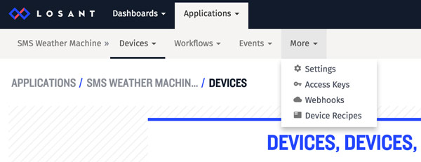

Setting Up Losant Incoming Webhook
Go ahead and sign up for an account at Losant. We will be using Losant to tie together a number of different data systems in order to build the bot. When you've signed up you can now create your first application. Inside the application you now need to create a Webhook.
![losant_webhook_menu.jpg losant_webhook_menu.jpg](https://www.losant.com/hs-fs/hubfs/Blog/_Twilio_Losant_SMS_Bot/losant_webhook_menu.jpg?width=666&name=losant_webhook_menu.jpg)

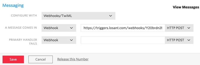

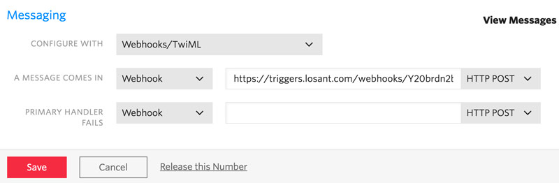

Go ahead and name the webhook and save it. Once created you will need to copy the webhook address and drop it into the Twilio configuration screen from the previous step.
![twilio_configure_webhook_losant.jpg twilio_configure_webhook_losant.jpg](https://www.losant.com/hs-fs/hubfs/Blog/_Twilio_Losant_SMS_Bot/twilio_configure_webhook_losant.jpg?width=664&height=217&name=twilio_configure_webhook_losant.jpg)
Now, when a text message is sent to your Twilio number, it will call a webhook at Losant. In order to take advantage of this you need to create a workflow.

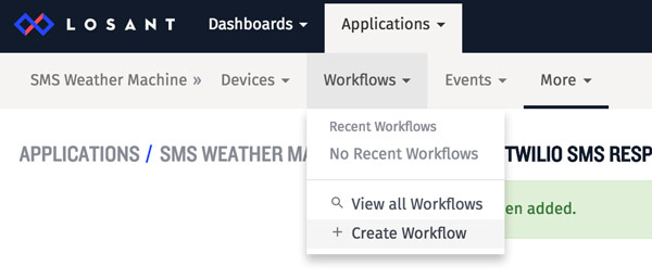

The fastest way to create a workflow inside of Losant is to use the shortcut menu at the top.
![losant_workflow_menu.jpg losant_workflow_menu.jpg](https://www.losant.com/hs-fs/hubfs/Blog/_Twilio_Losant_SMS_Bot/losant_workflow_menu.jpg?width=666&name=losant_workflow_menu.jpg)

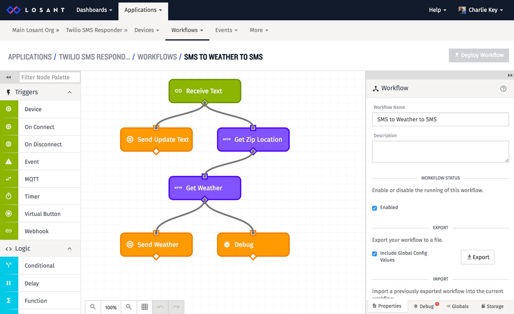

Once the workflow is named and saved you'll get a blank template. When we're all done the workflow will look like the one below.
![losant_twilio.jpg losant_twilio.jpg](https://www.losant.com/hs-fs/hubfs/Blog/_Twilio_Losant_SMS_Bot/losant_twilio.jpg?width=664&height=406&name=losant_twilio.jpg)
The first thing you need to add is a Webhook trigger node. It should automatically be set up to use the webhook you created in the last step. When the webhook is triggered from Twilio it will put the information on the "data" attribute in the payload. For an SMS message this will look approximately like:

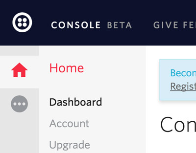

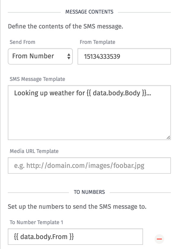

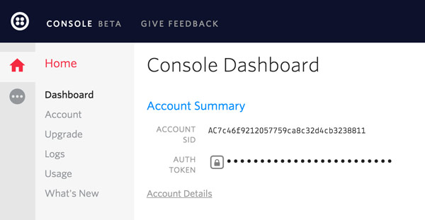

In order to keep the original sender in the loop you can now send them a text to let them know you're getting the weather. To do this you need to add a Twilio output node to the workflow. However, to configure this node you need to grab your Twilio SID and Auth token. This can be acquired from your Console Dashboard - just click the Home button on the left of screen.
![twilio_console_dashboard.jpg twilio_console_dashboard.jpg](https://www.losant.com/hs-fs/hubfs/Blog/_Twilio_Losant_SMS_Bot/twilio_console_dashboard.jpg?width=666&name=twilio_console_dashboard.jpg)
After you put in your SID and Auth Token you need to setup the node to text a message to the sender. This message can be really anything. The most important configuration field is going to be be the "To Number Template 1". This determines where the message is going to go. You need to make sure that this is "{{ data.body.From }}"
. Make sure you deploy your workflow to test it.
![losant_twilio_update_node.jpg losant_twilio_update_node.jpg](https://www.losant.com/hs-fs/hubfs/Blog/_Twilio_Losant_SMS_Bot/losant_twilio_update_node.jpg?width=460&name=losant_twilio_update_node.jpg)
Now, if you text a message to your Twilio phone number then you should receive a text back.

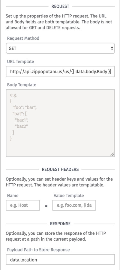

Next up is getting the actual location information for a zip code. This will allow you to get the correct weather information using forecast.io. To get the location information we need to add a HTTP data node.
The node should be configured for a GET request to "http://api.zippopotam.us/us/{{ data.body.Body }}
" and to set the response on "data.location
". This means that you're requesting the location information for the zip code that is equal to the text message body.
![losant_http_location_node.jpg losant_http_location_node.jpg](https://www.losant.com/hs-fs/hubfs/Blog/_Twilio_Losant_SMS_Bot/losant_http_location_node.jpg?width=460&name=losant_http_location_node.jpg)
This will grab the location and put it in the workflow payload. This information will look like:

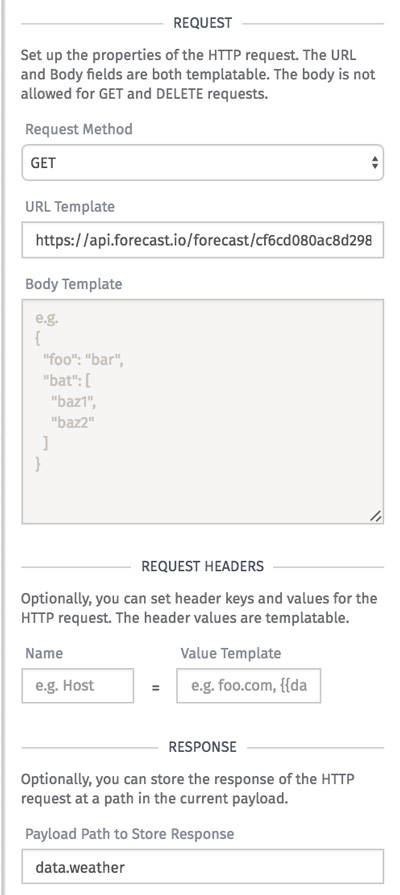

The next step in the workflow is to add another HTTP data node to request the weather. This web request needs to include the latitude and longitude from the previous location request.

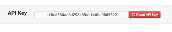

The first thing that you need to do to use forecast.io is signup and get a API key. The developer API allows you to make 1,000 requests per day. This should be enough for this application and most others.
![forecast_io_api_key.jpg forecast_io_api_key.jpg](https://www.losant.com/hs-fs/hubfs/Blog/_Twilio_Losant_SMS_Bot/forecast_io_api_key.jpg?width=666&name=forecast_io_api_key.jpg)
This node should be setup to send a GET request to the url "https://api.forecast.io/forecast/cf6cd080ac8d298c39abfc0be96d5022/
". The value right after /forecast/ should be your API key. The two other pieces of information in the request includes the latitude and longitude of the location received in the previous step. The node also needs to put the response on "
{{ data.location.body.places.0.latitude }},
{{ data.location.body.places.0.longitude }}data.weather
" in the payload. This will allow you to refer to the forecast in the final step.
![losant_http_weather_node.jpg losant_http_weather_node.jpg](https://www.losant.com/hs-fs/hubfs/Blog/_Twilio_Losant_SMS_Bot/losant_http_weather_node.jpg?width=460&name=losant_http_weather_node.jpg)

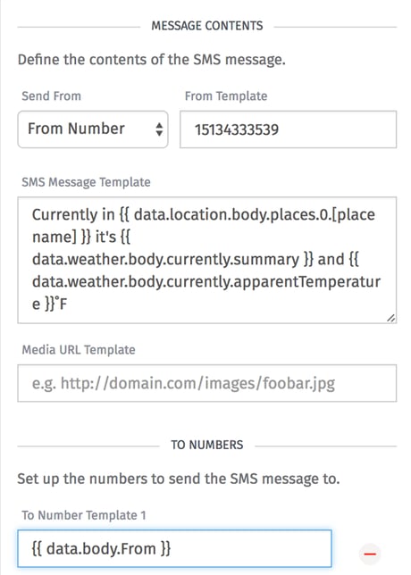

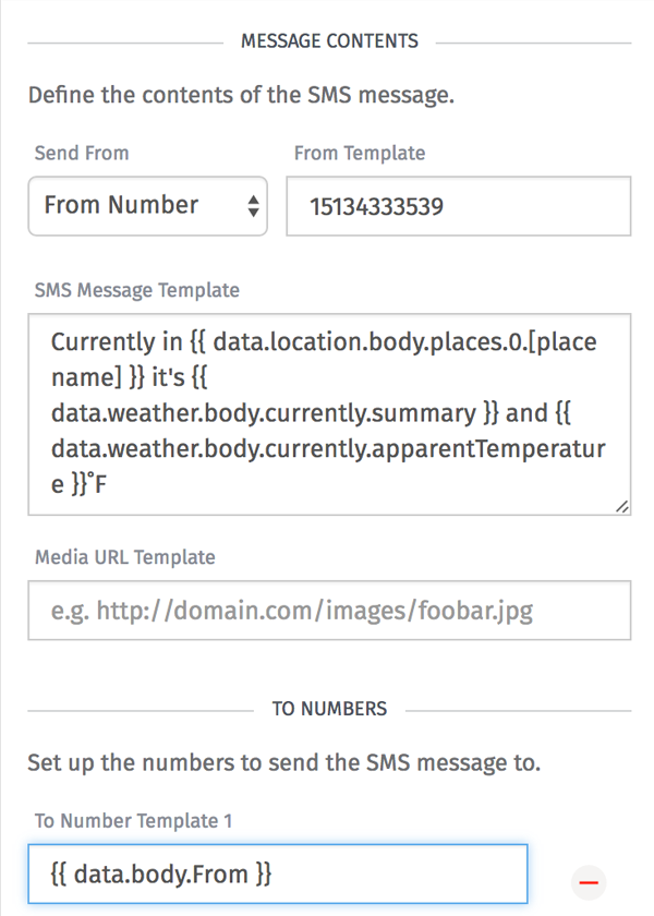

The final piece of this workflow and application is sending the weather forecast back to the original sender. You will utilize another Twilio node to achieve this.
You need to setup the node using the same settings as the earlier node. This includes a message like:
"Currently in {{ data.location.body.places.0.[place name] }} it's
{{ data.weather.body.currently.summary }} and
{{ data.weather.body.currently.apparentTemperature }}˚F"
The above message includes a number of items from previous steps including the location found and the current forecast.
![losant_twilio_update_node](https://www.losant.com/hs-fs/hubfs/Blog/_Twilio_Losant_SMS_Bot/losant_twilio_update_node.png?width=460&name=losant_twilio_update_node.png)

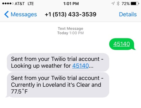

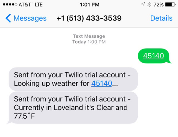

If everything is hooked up correctly in the workflow you should be able to text your Twilio number a zip code and see a response of the weather. Don't forget to deploy your workflow. It takes a few seconds for the API looks, which is why we included the earlier Twilio node.
Finishing Up
If everything in your Twilio and Losant application is working correctly you should be able to get the weather for pretty much anywhere. The final product looks something like:
![sms_weather_bot.jpg sms_weather_bot](https://www.losant.com/hs-fs/hubfs/Blog/_Twilio_Losant_SMS_Bot/sms_weather_bot.jpg?width=460&name=sms_weather_bot.jpg)
