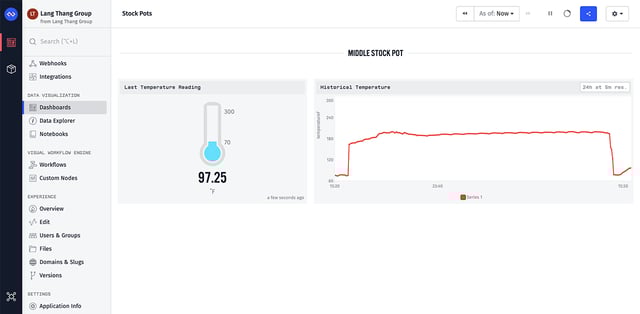

Using Losant to Read Temperature
After connecting the hardware, I went to the Losant platform to see the temperature readings.
I was able to quickly build a few workflows to pipe data from my devices to my architecture. Then I was able to get up and running with a dashboard in about five minutes. At this point, I could give our staff the ability to monitor our soup kettles while they were doing other tasks. I was also able to quickly monitor our kettles remotely.
However, to take it one step further, I decided to add it to my custom mobile app. I was able to build out an API using Losant Experiences and pull the data to my mobile app. Since the managers were already using the app to manage other restaurant tasks, this let them check the pot without having to switch to another application.
Now that I’m able to monitor the cooking and capture the data, I can set up alerts to let me know if something is going wrong. Recently, I had an issue where the pot had been accidentally turned off (tripped circuit, user error, etc). I added a workflow to check if the pot has maintained an average temperature between 100˚F-160˚F for more than an hour. This tells me that something was wrong with the pot because it should never be at that temperature for more than an hour. The food danger zone is between 40 °F - 140 °F, so I set my notification range to be higher to allow me time to fix the situation before it reached the danger zone.
