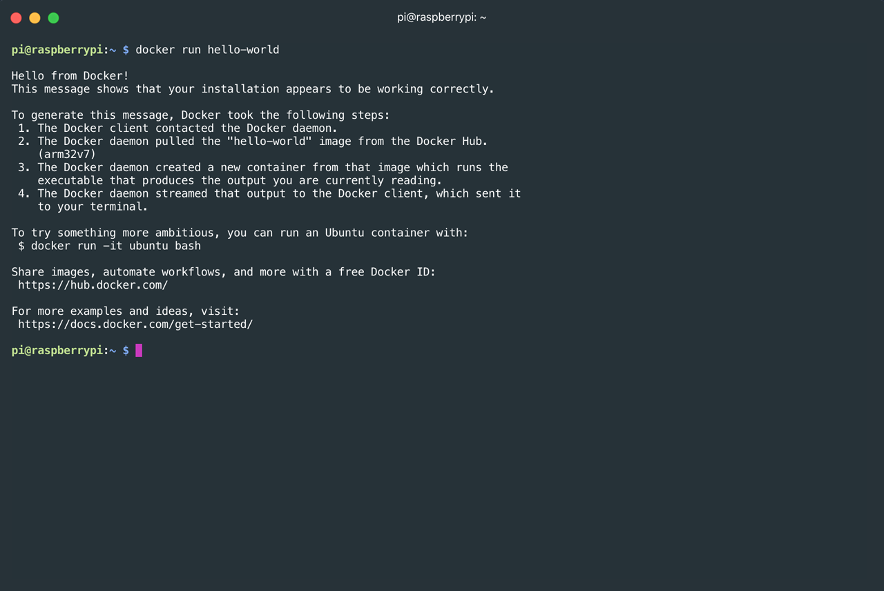

To make it easy to test your installation, Docker provides a hello-world container that can be run using the following command:
docker run hello-world
If successful, the container will print the following information and then exit:
